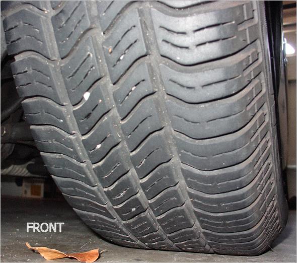

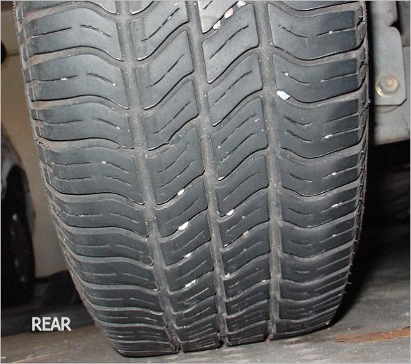

Originally Posted by 8307c4 View Post
Increase Tire Pressure - Don't go past max.psi sidewall, you'll only wear the tires down the center, but max.psi sidewall is the best psi.
Originally Posted by trebuchet03 View Post
Prove it...
Using my ride as an example - I just ran outside and took some unmolested snappys.
  • Pirelli P3000 tires: bought on 17-Sep-2004 (been on two different HX CiViCs)
  • Rotated once on 11-Nov-2007, when I had a flat (picked up a sheetmetal screw).
  • 60,000+ miles @ 45-50 psi (I only check them once a month, give or take)
Some feathering can be seen on the rear tire (left-side center blocks). This was the ONLY tire that had screwy wear, and it happened on my other HX, not this one. Probably an anomaly, defect, alignment problem, or because I've only rotated them once in 60K miles.
Sorry for the dirt and rocks, but we had severe thunderstorms here last night!
