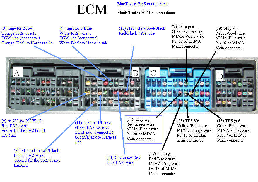

After unplugging the ECM's 4 harnesses for accessibility, I stripped back the dressing on the 2nd harness about 3" so I could get at the individual wire I needed to work on. It took a very sharp knife (another project of mine) to cut that dressing in 20degF temperatures. That stuff turns pretty hard. The wire in question is the red wire on Pin 14 of the B harness. The 18-22 inline splice worked to easily make a connection between the wire going to my switch and the clutch switch wire without stripping or soldering.
I didn't really know what I was looking for, but I couldn't find something I was convinced was a ground wire to splice into, so I wrapped the switch ground around one of the stand-off bolts for the ECM and vigorously taped it there. It worked. I re-dressed the B harness wires with 3M SUPER-33 black electric tape (to use this stuff is to experience transcendent bliss) and ran the blue switch wires (blue because that's what I had) underneath the carpet, passed the OBDII port, and around to my shifter knob. After I confirmed that it worked, I ran the wires underneath the shift console and out through the boot around the shifter (a la Mike's MIMA technique http://www.youtube.com/99MPG#p/u/10/Bbs-YgL24iM). The switch is secured via super-33 (!!) right under the thumb and the wires are all hidden from view. Maybe I'll add epoxy putty to clean it up a bit more at some point.

The same ECM connector B has a ground wire that I use for the FAS system. It is pin 20, A brown/black wire.
The taped ground will probably work for a while until humidity causes the copper and steel to corrode, so when you get a chance, you may want to move the ground.
Photo showing the location:
http://www.99mpg.com/mima/pininstall...ctionsr1.jpg,0
