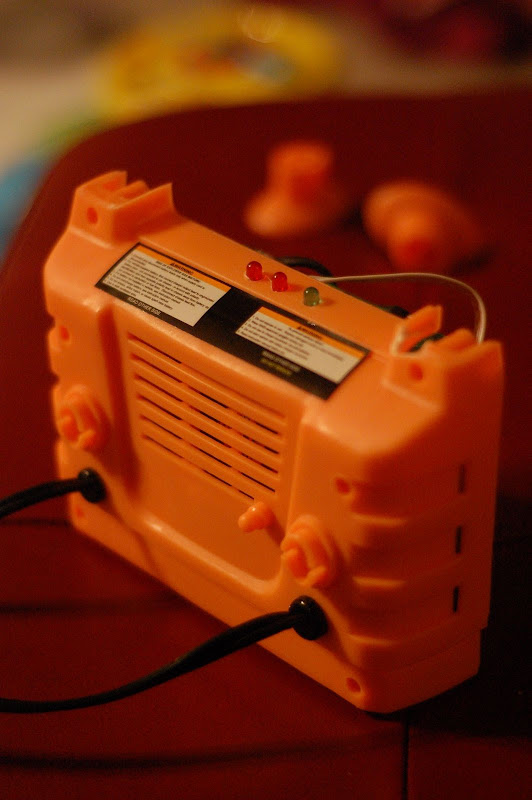

As many of you FAS-ers have experienced, my alternator isn't running enough to keep my battery charged. I bought a chager at Harbor Freight, but I don't have the discipline to drag it out every night. My plan is to keep the charger on-board in the engine bay, and have a dedicated length of extension cord that I can simply plug into the nearest exterior outlet when I park in the driveway.
The unit has some stand-offs to keep the fan clear for adequate airflow. Since the fan side of the unit will be facing the inside of the engine bay, I wanted to remove the stand-offs.
Stand-offs coming off.
Relocated indicator lights to be visible from fan-side as they would otherwise be covered when the unit was mounted.
handle removed, lights relocated, stand-offs removed. I'm going to just let it do it's job normally for tonight, and tomorrow find a good spot for it.

I had considered that, and figured that since most of the actual operation of the charger would occur at night w/ the engine off it might be ok.
BUT...the engine bay idea didn't work out anyway (I should have expected as much with an econobox). I mounted it right in front of the driver's side front tire, in the bumper cavity where cold air intakes are usually designed to run. I was shocked by how clean it was in there. I think I introduced the first dirt that area had seen in its 7+ years.
Maybe I've misunderstood the instructions, but it seems when I kill 120V power to the unit, under charging mode, it will stay in charging mode, with the cooling fan running, until I remove the 12V clamps. However, if I just attach the 12V clamps to the unpowered unit, just the trickle charge light will come on. I guess I'll just install an in-car switch to kill the 12V side..?
