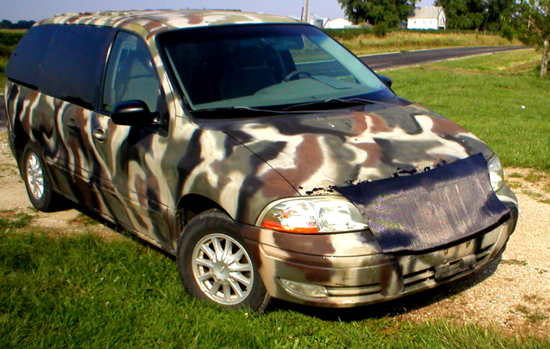

I am investigating better areo for my camo van.
I've thinking of stretching dacron fabric over the front of my car to build an areo front shield. The beauty of Polyester fabric is that it shrinks when heat is applied. Making a taunt smooth surface.
Today I got a piece of material stretched it over the front of the van and was amazed at the nice shape that was formed. It connects to the hood and headlights to a great extent. I hadn't treated the car with any mold release. Just a trial run. I am trying to decide whether to remove the plastic cladding and stretch the cloth over a hoop at the bottom. After seeing this I may just make the composite over the existing bumper cover.
My trial reminded me very much of the front end protective bras that were widely used for stone and rock chips. I bet they could be revived with slight modification to their original designs.

Well here is my execution of what I was working on. I will need to get it attached. Right now it is just a single layer of 10-12 oz carbon It is still green but will cure in the next day. will need to be attached. I am thinking shoe goo at the bottom and maybe velcro at the top. It needs to be painted to match the rest. It will probably need more layers to withstand the wind.
This van has a duct in the air intake in the bumper. That air is funneled into the radiator, ac and the two trans coolers. Let's see if the van can keep it's cool.

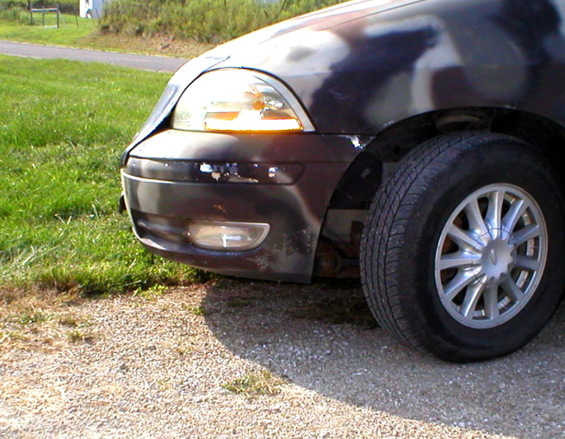

and in profile:

Carbon fiber / epoxy composite? Epoxy it in place, and leave a gap between the hood and bumper, so that it's still easy to open the hood.

Yes I used, IM carbon fiber and west system epoxy. It is just a wet layup. I didn't bother to use duct tape or other mold release over other areas, my paint rather is ratty. I have 10 yards of some great triaxial stuff I am thinking of putting a layer of kevlar in and then the triaxial weave. I have about 3 hours in the project and would like to test before doing much else.
Good idea bonding it to the hood. There is a safety catch that should be activated manually from under the lip but could be controlled with an extension cable or rod though.

Made a 70 mile run this afternoon and the panel hung on fine. Engine did not change temps from normal or overheat in 90 degree temps. Even had to stop at railroad crossing for a few minutes.
Next step is to make it stiffer, glue it on then finish it.
This techique of blocking the upper grill seems to be pretty reliable.

I had a chance to work on my front air damn.
I have to travel next week on a 300 mile ride and the original fairing was quite flexy. I had enough epoxy to add another layer and a bit more. I was afraid that I would be seeing my original fairing bouncing off the windshield along the highway.
So now I got rid of the slight imperfection where the hood ended. The current fairing is now 3x as stiff. I am still taping it on until I get more epoxy. I want to make it stiffer and perhaps make it wider to prevent damage from some deer strikes. I want to add a few layers of Kevlar then some more 20+ oz of carbon.
