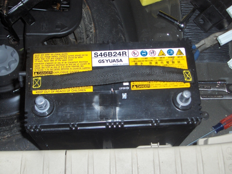

Well, I pulled the 12V out of the Prius today. I checked to see if I could pull up the sticker somewhere, but it really doesn't look like anything is under there to add water. Could you clarify Bob? Here is the battery.

Can you tell if it's a floodie or an AGM? I've seen it referred to as an AGM in a Toyota manual but seen people check their own and find a OEM floodie.
Check carefully with raking light on the battery top to see if you can see the edges of the rectangular cap that covers the fill holes. You could try with your fingernail or a flat head screwdriver to find the seam of the cap. Then you could just cut the label along the edge instead of trying to peel it off. The cap should pop off with a bit of gentle prying with the screw driver. if not there may be some hidden clips or something and the label will have to be peeled.

It appears to be AGM as there is no sloshing water sound when I move it.
I tried this, it really doesn't appear there is any cover under the sticker. This doesn't surprise me too much if it is AGM as they're never supposed to need water.

I reinstalled the battery last night as the wife needs it for work today. The desulfator is still on it and chugging away. I got done installing it at roughly 7:30pm last night and the voltage was at 12.2V (I don't think I got it fully charged though). As of this morning at ~7:30am, the voltage was still at 12.2V. We'll see if things improve with the car charging it and the desulfator on it. If not, it looks like I will try to find a way to discharge the battery while its still in the car so I don't need to go through the hassle of removing it over and over. Its still all very preliminary, but it appears the deep discharge may have helped.
I don't think any benefit has come from the desulfator, they usually take a while to do their work. However, with the battery voltage as low as it was for as long as it was, I'm guessing the desulfator will eventually help.

It is am AGM then. I guess revival is worth a try. Hopefully it's not dried out. (crosses fingers)
You could charge it and cycle it in the car while still installed. It won't damage anything. You could just leave the stereo on or lights and just make sure the DC/DC isn't charging it.
