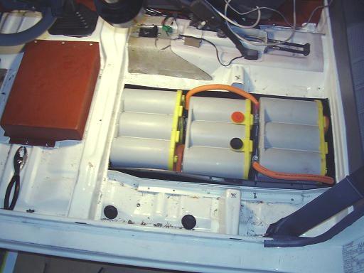

Definitely worth considering. This car has gel batteries installed in the floor (including under the front seats) for just that reason: (and also for aesthetics - to keep batts out of the motor compartment)
Roger Stockton's 1987 Suzuki Forsa
(Note: Optimas. )
