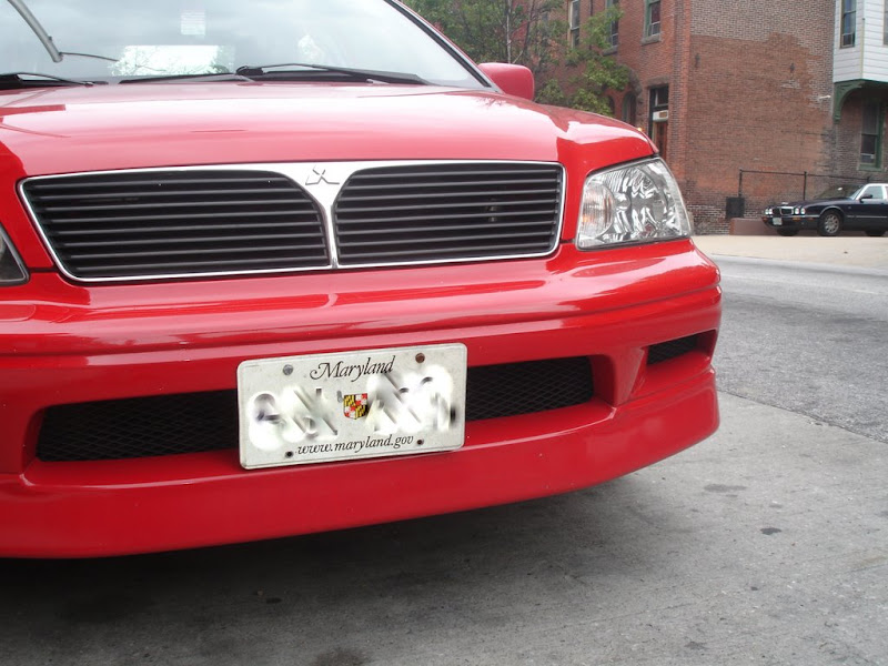

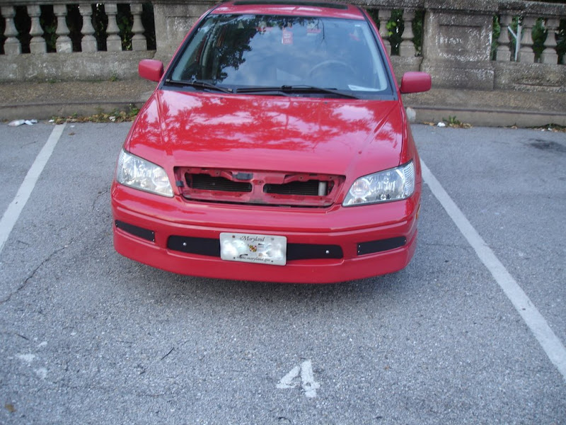

And here are the obligatory before/during/after pics for the grill block. I was thinking of painting the bolts and washers black but actually like the look, so I'll just keep 'em like that
