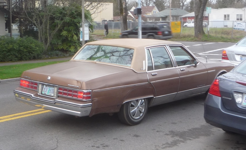

So are the Pontiac Parisienne and Cadillac Coupe De Ville models what you're referring to?
Here's a photo of a 1986 Pontiac Parisienne with wheel skirts:
Maybe I can find some in decent shape in a junkyard.
And, What's involved in putting an aerodynamic glass on the back end? I'm aware the trunk will need to be shortened in such a modification.
