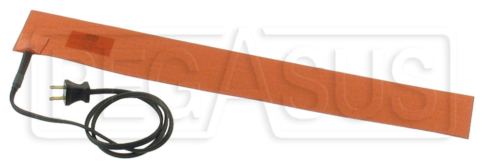

Hello -
This thread on engine heaters :
Terrible mpg's = new interest in old ideas.
Made me want to ask about this :
Pegasus - Heater Blanket, 2.5 x 20" - 200 watts, 120 volts
Getting proper oil flow while warming up a cold engine can be difficult. The viscosity of cold oil can be high enough to cause the oil pump to cavitate which results in greatly reduced oil flow to the bearings and camshaft. Because of the high viscosity, your pressure gauge may show high pressure, but that does not necessarily mean that the engine is getting an adequate volume of oil. This is especially critical on racing engines because of the large bearing clearances that are often used. Pre-heating the oil in the oil tank of a dry sump engine is a great way to prevent this problem.
Our Small Heater Blanket is rated at 200 watts / 120 volts AC. This size is recommended for our medium oil tank or other tanks of similar size. Comes completely assembled with cord and plug.
Note: These heater blankets cannot be shortened by cutting. Plugging them in for more than 30 seconds when they are not in contact with a heat sink (such as an oil tank) will overheat them and severely reduce their life.
Pros :
1 - $52 is an ok price for a heater (right?!?!?)
2 - Appears to be flexible for installation, you just need to have a 20" flat part of the oil pan to attach it to.
Cons :
1 - Fragile. Easy to damage from overheating if it "disconnects/falls off" the oil pan.
2 - Easy to literally get burned from using it. At least that's my impression.

McTimson -
Originally Posted by McTimson View Post
The eleproducts timer only works if you already have a car with a block heater installed.
How does the heater blanket stick to the oil pan? Does it have to sit on top of it, or do you make your own mounting setup for it?
That's a good question. Here is one way, but I don't like it because I want to be able to remove it easily :
Pegasus - Self Bonding Silicone Tape, 1 inch x 36 ft roll
Our silicone rubber tape bonds to itself without messy adhesive and without sticking to other materials. Recommended for wrapping over heater blankets as a means of protecting them and holding them tightly to the oil tank. Great for insulating odd-shaped electrical connections, including the back of your master battery switch. No adhesive means no residue when the tape is removed, so it could even be used to temporarily hold odd-shaped parts together during bonding operations.
In my addled brain I was imagining a setup where I could "push" the blanket onto the heater with some kind of support and jack mechanism. When I go to work, I just turn it off, undo the "jack", and pull it out from under the car.
But, my problem may be that because I haven't seen how it is used, it may not be easy to install as I imagine.
More hrmmmmmmmm ... It looks like it wouldn't work for where I would want to install it :
The exposed part of the oil pan does not have a 20" long flat section, which is what I think I would need. Sooooo, I think this would make more sense on a larger-displacement engine.
