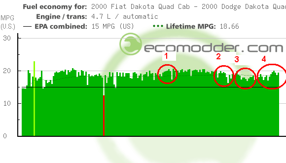

Originally Posted by mechman600 View Post
Anyway, t vago, thanks for the info above. Very informative.
You're welcome. Looking forward to seeing your HAI setup.
So, I discovered two things that were missing from my data collection rules for this A-B-A trial. First, I noticed that it was incredibly, remarkably humid on the drive back. While that might be good for the truck's engine, it certainly was not good for the driver, so I ran the A/C as a dehumidifier, with the predictable hit on fuel economy. So, A/C usage is a disqualifier.
Secondly, it might be possible that I might have to drive the truck at some point during its 8-hour cool-off period. Again, that might throw off the fuel economy, so I added that as a disqualifying factor.
Still, I can definitely see results, and the results are definitely not the kind of statistical noise associated with testing something like fuel magnets or some other such nonsense.
1 - fabricated and installed version 2 aerocap
2 - transmission torque converter stopped locking up
3 - removed version 2 aerocap
4 - installed HAI
RIP 2002 Chrysler Sebring Convertible GTC with transplanted 3.5L LH engine - 12 OCT 2002 to 20 JUL 2012
