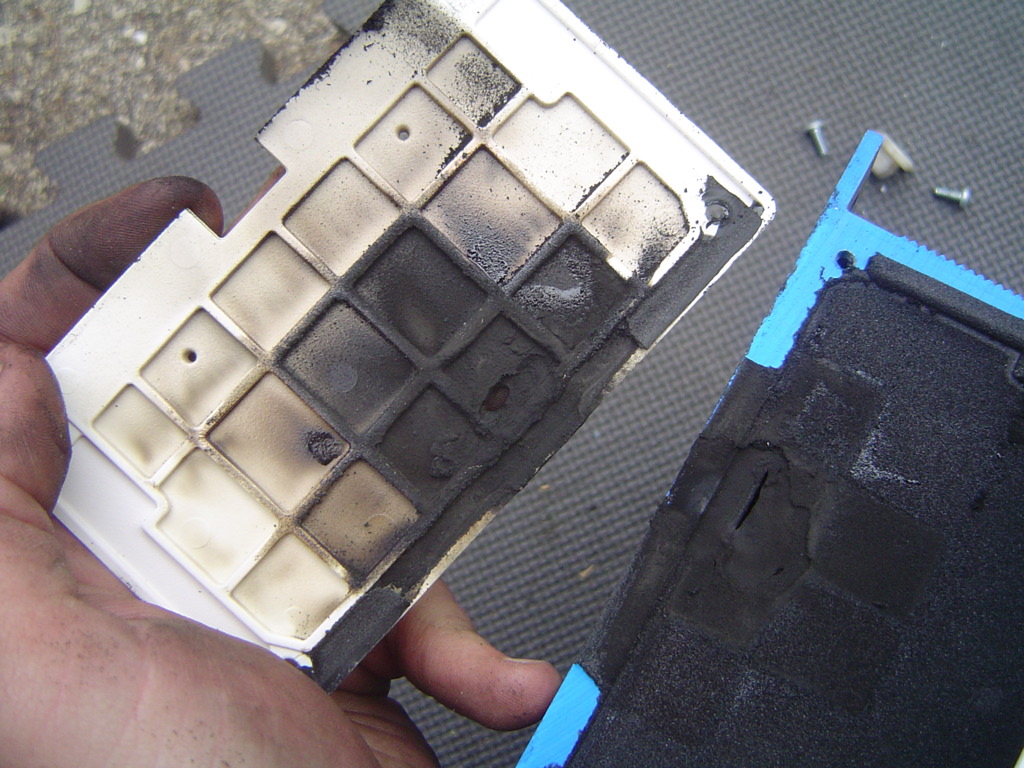

electric motorcycle blows upHowever, Ben’s story isn’t all gumdrops and happy endings. One day, while out riding the motorcycle he managed to blow up the controller. He and the bike are fine and he’s got it going again, but when attempting a DIY project like this, especially because it involves a vehicle responsible for your safety, it’s always good to go in with open eyes and be ready for the unexpected. That said, it wasn’t as dramatic as it sounds.
