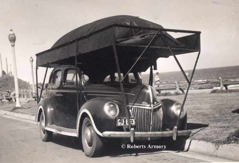

JockoT 08-10-2017 03:21 PM
http://www.robertsarmory.com/Coal-gas-car-Sidney-1.jpg
teoman 08-11-2017 01:35 AM
I wonder if it is compressible.
Co is not really stable, but if you could have a shop compressor compress it that would give you a bit of convenience, so you can leave all the heavy stuff at home and could potentially have better filtering. But your range will be limited to very short erands.

cRiPpLe_rOoStEr 08-12-2017 05:01 AM
Originally Posted by JockoT (Post 547117)
I have already considered to perform experiences with a "gas bag" like that, but I would rather try biomethane. Only downside is that it would be nearly impossible to license a setup like that in my country.
