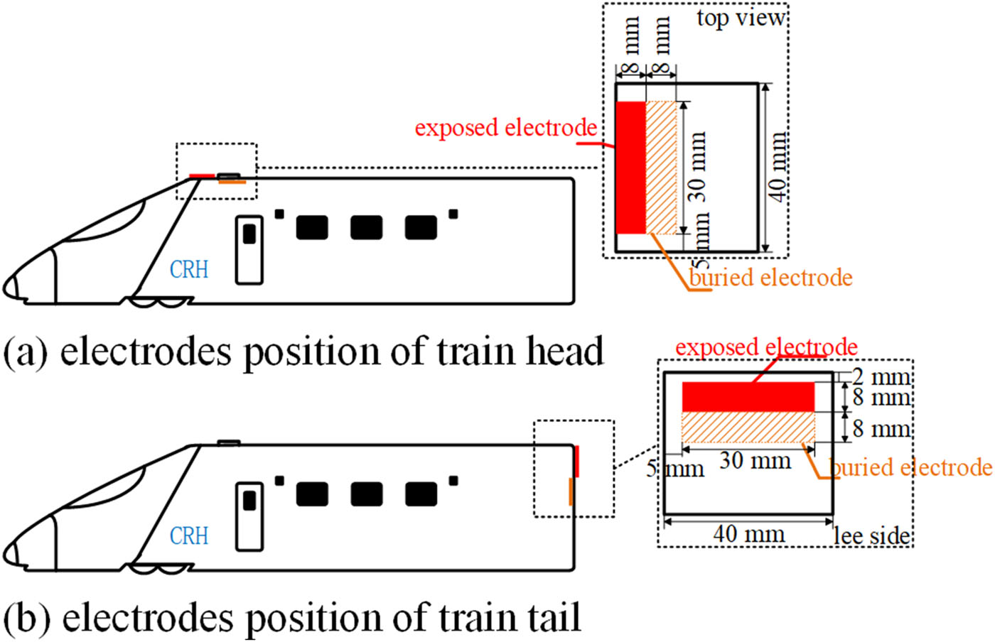

Premier Aerodynamics does a great job of reading/summarizing research for you, like this paper:
Effects of surface dielectric barrier discharge on aerodynamic characteristic of train
He NBs that the vertical DBD on the back of this train model is Reynolds number (Re) independent.
He does a whole lot of other aero tips and tricks videos that people here would like.
