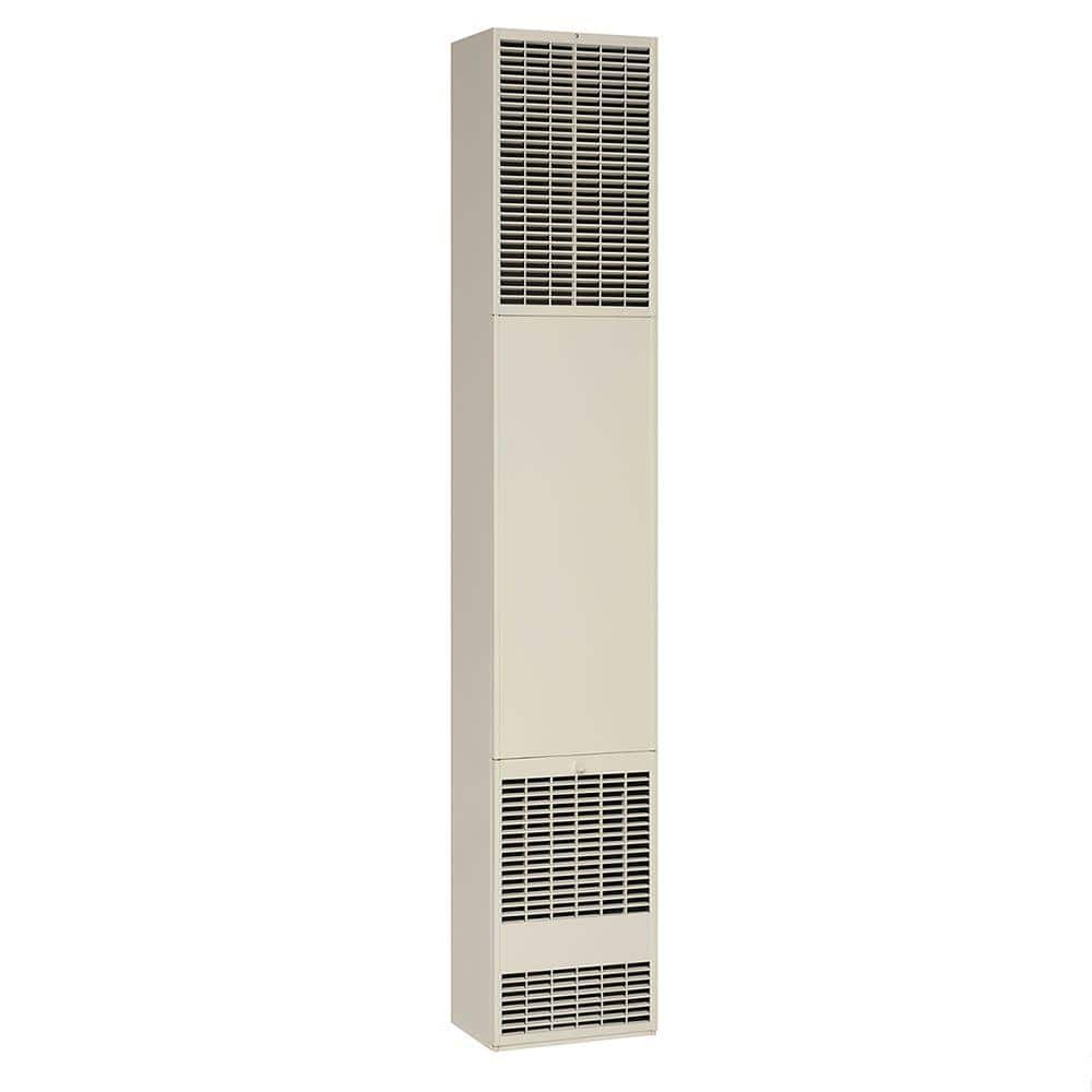

This is my exact unit I currently have (Coleman 7663):
