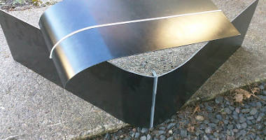

Interesting undertray and splitter on this race car.
I stumbled upon these guys site. A couple good simple articles, but what I like most is that undertray/diffuser design.
https://www.langracing.com/e46-race-...now-available/

arcosine 12-09-2018 09:07 AM
That's more of a bash plate.

California98Civic 12-09-2018 10:51 AM
It is elegant and would be relatively easy to install, I guess, but there are a lot of open areas along the sides that would be drag producing. I like the comment about it being "more of a bash plate" ... one with a diffuser.

westygo 12-13-2018 01:10 PM
Along the sides begs for side skirts...

freebeard 12-15-2018 06:48 PM
The linked article doesn't have material thickness or weight. Do they disclose that?
Any wider and it would be hard to get under the car. :) The areas before, between and after could have solutions that attach to the flanged edge.
It looks like a job for Polymetal/Alumapanel to me:
