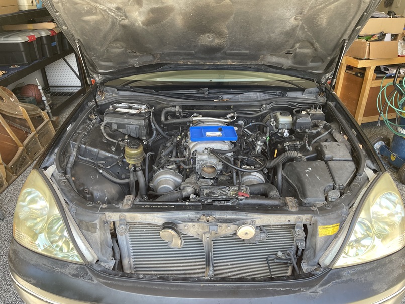

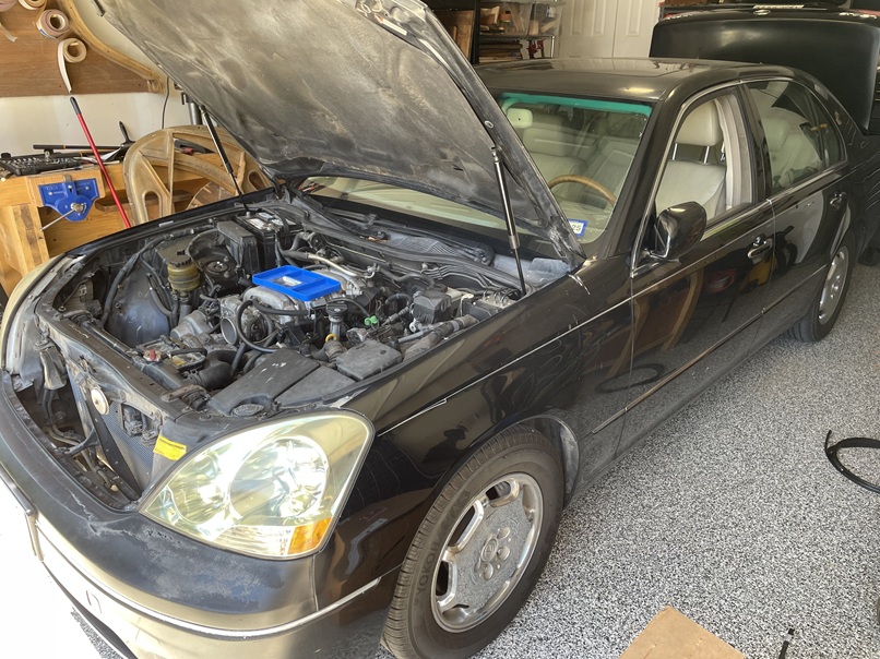

I made a little progress tearing down the LS430 today. Here it is before:

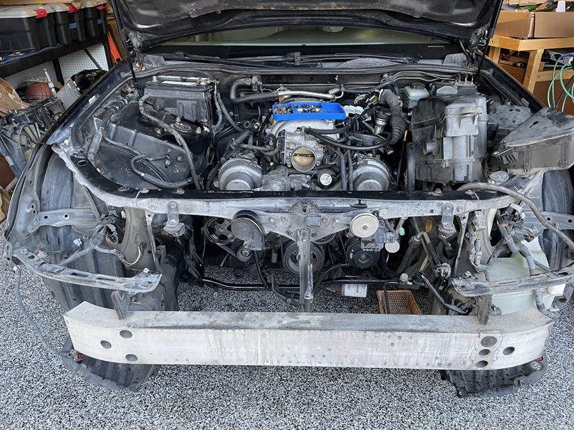

Here it is after:
The more I tear into it, the more I'm excited to convert things to manual operation. The grimy power steering system was especially making me feel this way.

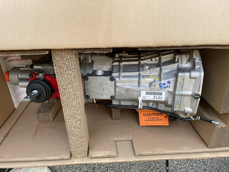

The transmission has also arrived. I'm really excited about getting that installed.

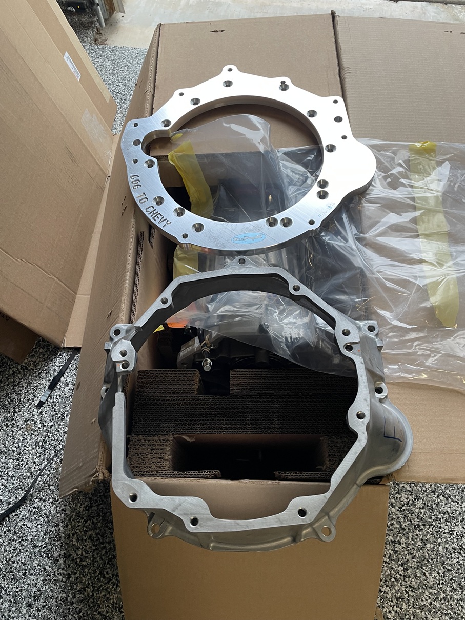

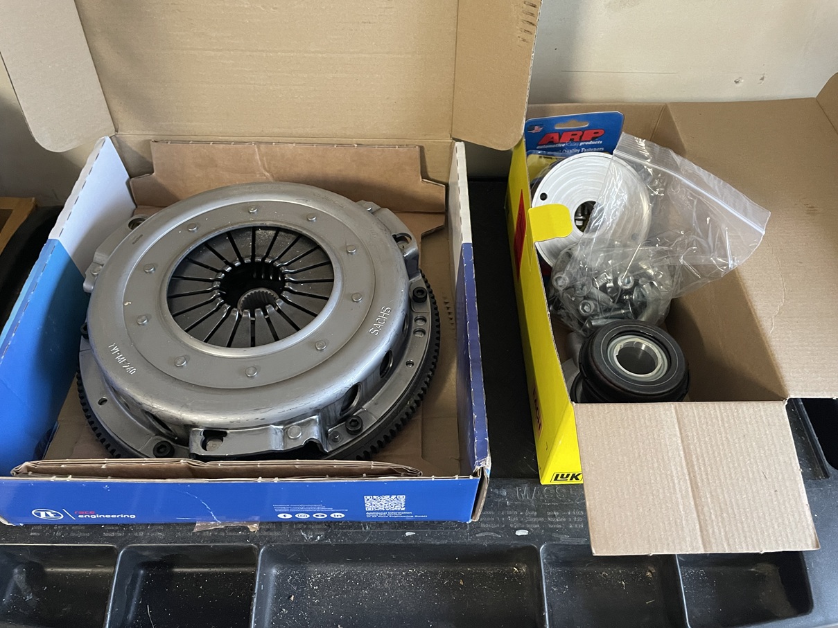

Some more parts have arrived. I got the bellhousing, which is a standard unit for a T56 to Chevy LS engine. I also got a T56 adapter kit from Dieselpumpuk, which is designed to work with the LS bellhousing and connect it to the Mercedes OM60x series of engines. The kit also came with a heavy duty clutch, hardware and clutch slave cylinder spacers.
Right now I'm trying to figure out what I am going to do for the clutch pedal. I'm leaning toward an aftermarket Wilwood option. There's also the Wilwood pedal assemblies that have the brake and clutch pedals/master cylinders. That might be an interesting option. That scenario would have me going full mechanical on the brakes with no booster. The wise choice would probably be to just stick with the factory brakes and find a standalone clutch pedal assembly that fits and clears the factory brake booster.

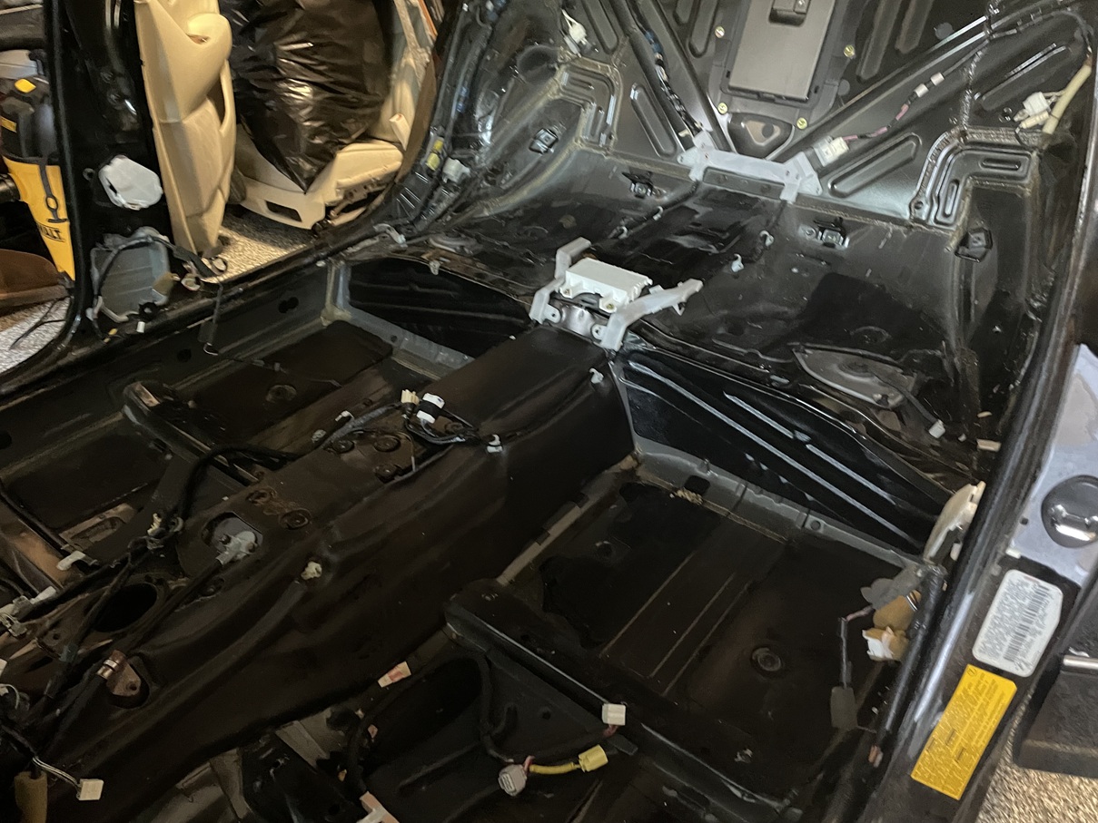

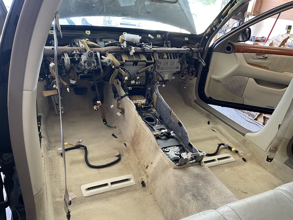

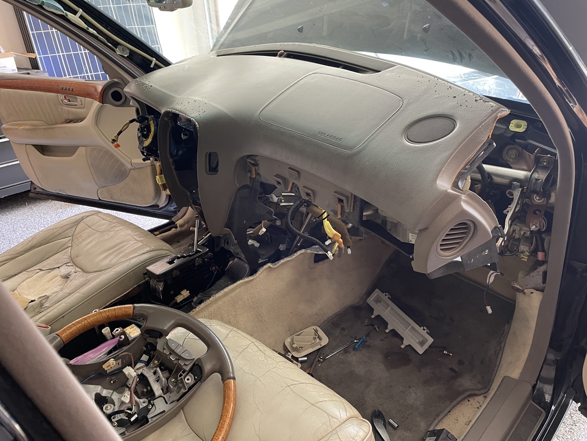

I've been getting to work gutting the interior of the LS430. Initially, I was on the fence between keeping things mostly stock interior-wise and going all in. I am glad I decided on going all in. There are just so many plastic pieces and lots of them are incredibly brittle. They crumble to pieces if you look at them wrong. The interior also looked pretty good from far, but it was definitely far from good.
Here is the dash getting removed. You can see how it has the common issue with these vehicles where the dash bubbles.
After dash and seat removal and some cleanup:
Here's the back after removing the seat and carpet:
