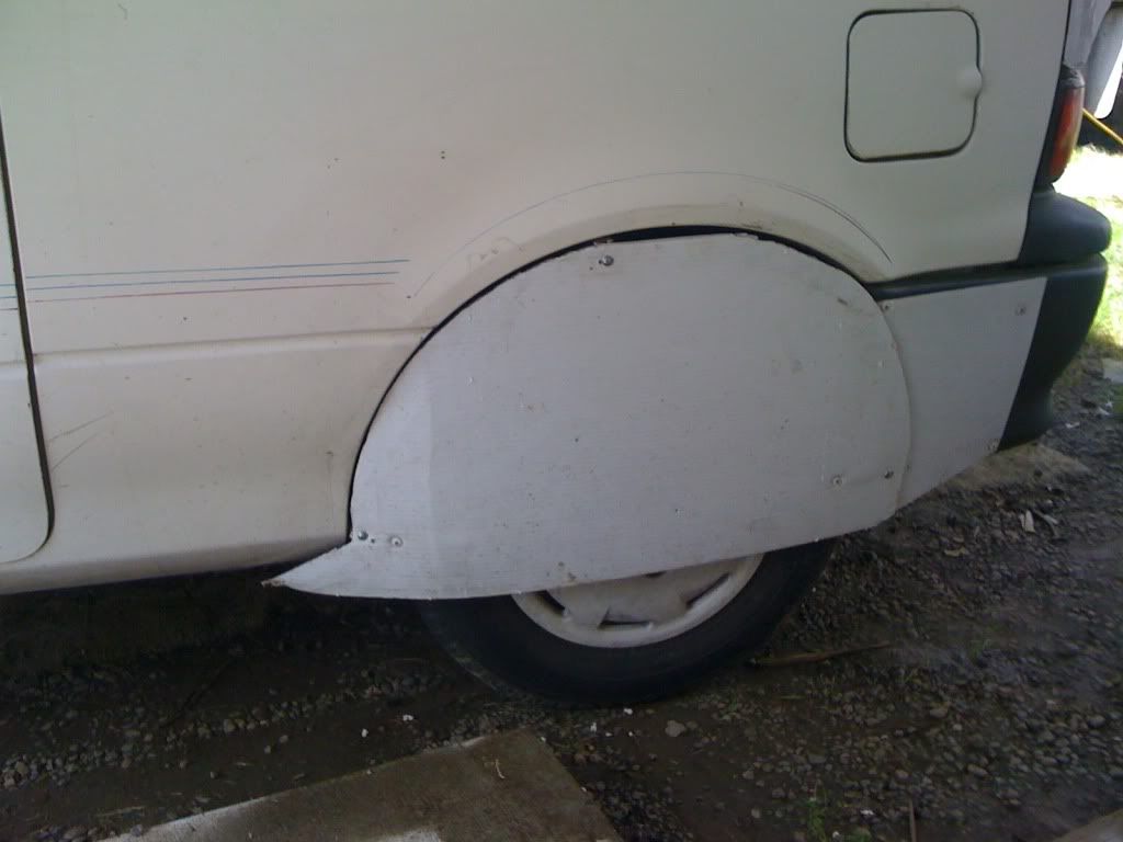

stage 3 prototype rear wheel skirts. was going to make them 3 piece skirts then noticed the front "Wheel spat" will be completely covered by the side skirt so went with a two piece instead. Bolted the brace directly to the Wheel skirt then but new brackets on the car so 3 bolts remove the skirt. painted screws are "Permanent", just undo the 3 shiny screws to remove the skirt.
