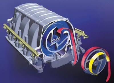

My variable intake doesn't use another set of runners, rather it has a chamber connecting either sides of the runners with a flap in the middle that opens at 4000, or 4900 RPM(don't know for sure which one. On the J25 it opens AFTER VTEC. I think on my J30 it opens before VTEC.). I don't know if it has any variable rpm/throttle position logic. Either way, the first transition is quieter than the second, if that helps you figure it out.
Here is a drawing. You can see the firing order listed, so when cylinder 1 is charged, it sucks all the air coming in down into cylinder 1. Cylinder 1 fires and the next cylinder is cylinder 4. With the flap closed, the air has to reverse and go all the way back around the loop and into cylinder 4. With the flap open, the air has to reverse and can go through the center of the intake manifold, shortening the path.

Probably true, most likely won't make a big difference, but it should still make a difference. It would be nice if they would develop these parts and make it an option to have them, or you can get the el-cheapo engine. I know which one i'm picking.

Variable intake is primarily useful on NA engines, whereas the trend is to go turbo. But yea they can be very effective. The 911 GT3 and Lexus LFA engines are NA, non-switchable cam profile 9000+rpm, but they have pretty good low end torque thanks to 3 switchable intake runner lengths.
