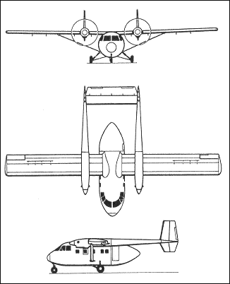

Take a look at this plane :
The IAI Arava .
http://www.aviastar.org/pictures/israel/iai_arava.gif
http://farm6.static.flickr.com/5022/...df56f42cb6.jpg
It sure would be nice to have attached flow with a tail that short !
