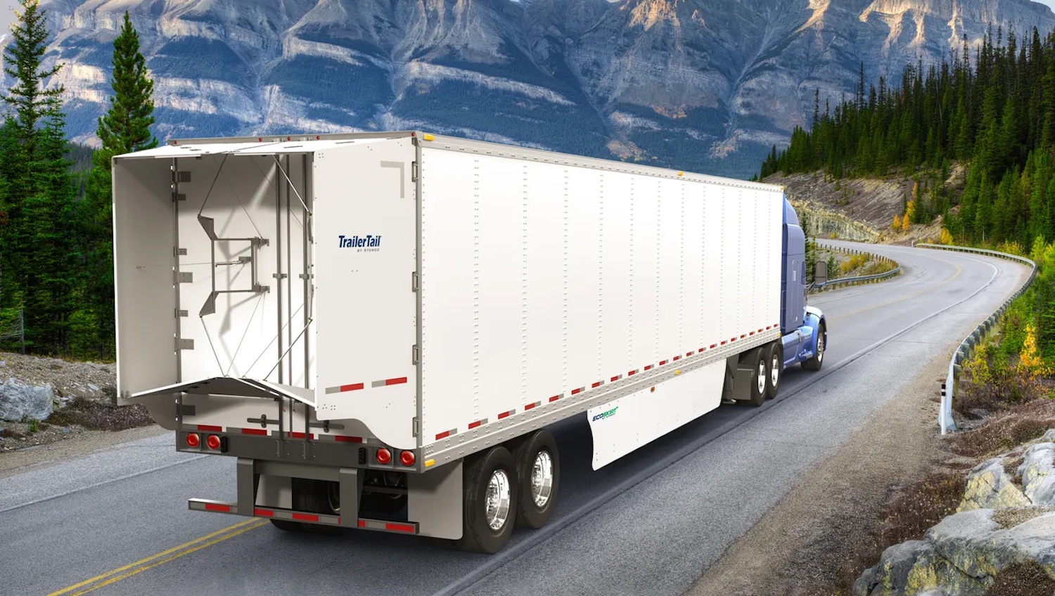

i also have a hole the size of an engine air filter in the front engine tray from running over a stump. i wonder how much that affects my cd
i want to make something like this for the back of my car versus a super long boat tail

That's particularized to the box van shape. Better the Mercedes IAA Concept
https://i.imgur.com/W8TA6tA.jpeg
well yeah i would follow the natural curves already at the rear of the ioniq
does mercedez mention how much drag is reduced when that rear extends out?
So far, not a word from them about it.
