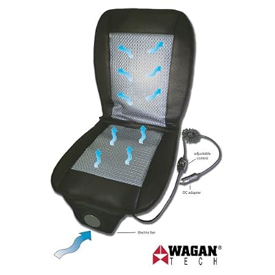

My wife was also very thoughtful and picked me up a few of these seat covers recently. They were very reasonably priced and are a step up from the normal beaded seat cover. I haven't had a chance to put them in the car and try them. I'll be sure to write a full review once they are in. She is an A/C junkie (75 degees and that sucker is on ), so I really hope they work good.
Amazon.com: Wagan Universal-Fit Air Circulating Ventilated Seat Cushion: Automotive
None of these options are actually air conditioning, but direct cooling is much more effective than blowing air on you. I've read the OEMs are looking into in seat cooling as a way to cool down passengers. This allows them to downsize the A/C system considerably.

At the risk of splitting hairs, your seat cushions are blowing air on you. But the direct, localized cooling does sound tantalizing. You'd be consuming less power to produce such focused cooling. I did read dremd's thread, but have not seen hugely successful results. I'm not crazy about cutting up my seats and running fluid through them. In contrast, your forced-ventilated cushions seem desirable. I look forward to your review. Please post a link here when you do.
Now how about if we take those cushions and use the cold air output from the vortex tube to feed it?
-Terry

I would think that system would be quite a bit more efficient than conventional A/C.
Also, I haven't looked extensivly at the seat cover, so I'm not sure if the air cools down the cover itself, or if it leaks it out slowly and it blows on you. I assume it would be the later.

I was assuming the same thing, based on the wavy blue arrows emanating from it in the picture.
