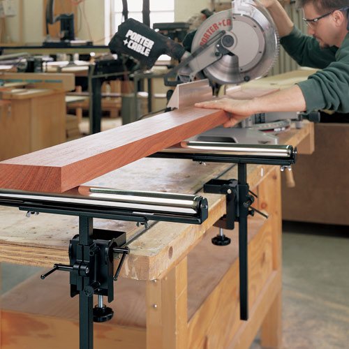

My brother Nathan, who works for UPS suggested those omnidirectional rollers, and I was going to try and use them, but the rollers I am getting are ready to go:
(click on image for link)
I've ordered four of them, which should do the trick.
