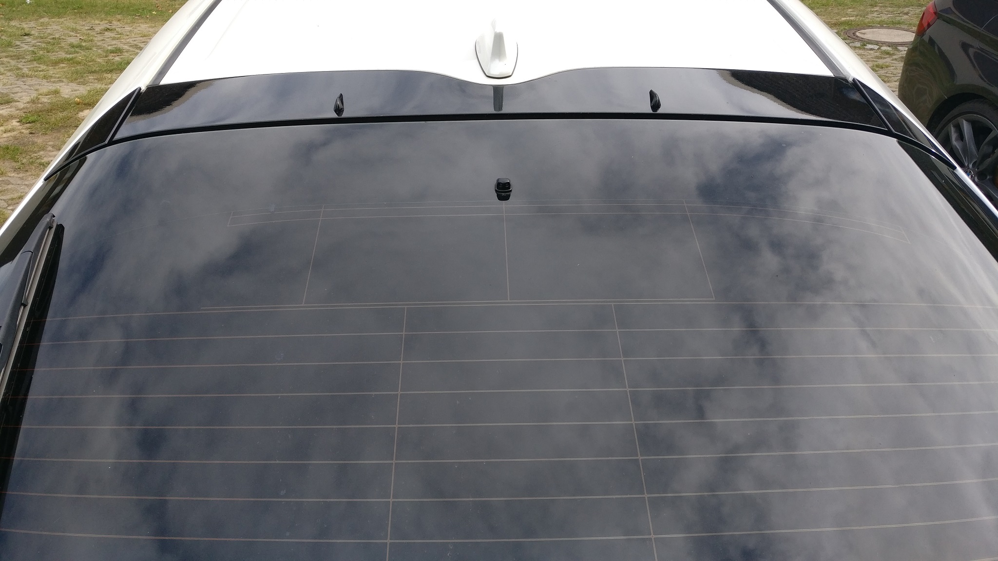

Some days ago, i had a unintended "tuft test" with waterdrops.
To fill the wet parts with some air, i stuck some Vortex gens inbetween.
The result is not jet valid, but i´d say its messurable. To my own suprise...
