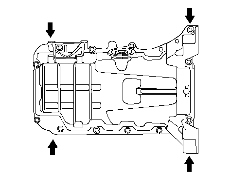

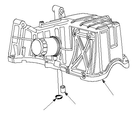

I don't think a sump heater would work as the Jazz has an in sump transmission with the casing all webs, etc.

The transmission isn't actually in the sump (like the BMC engines) but attached to the end of the sump. This is the sump:
And in Plan.
