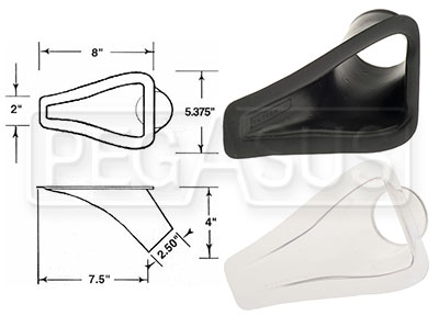

cooling air ..
set one of these ducts in the belly pan , put air ducting hose on it .if required
https://www.pegasusautoracing.com/pr...p?Product=3627
