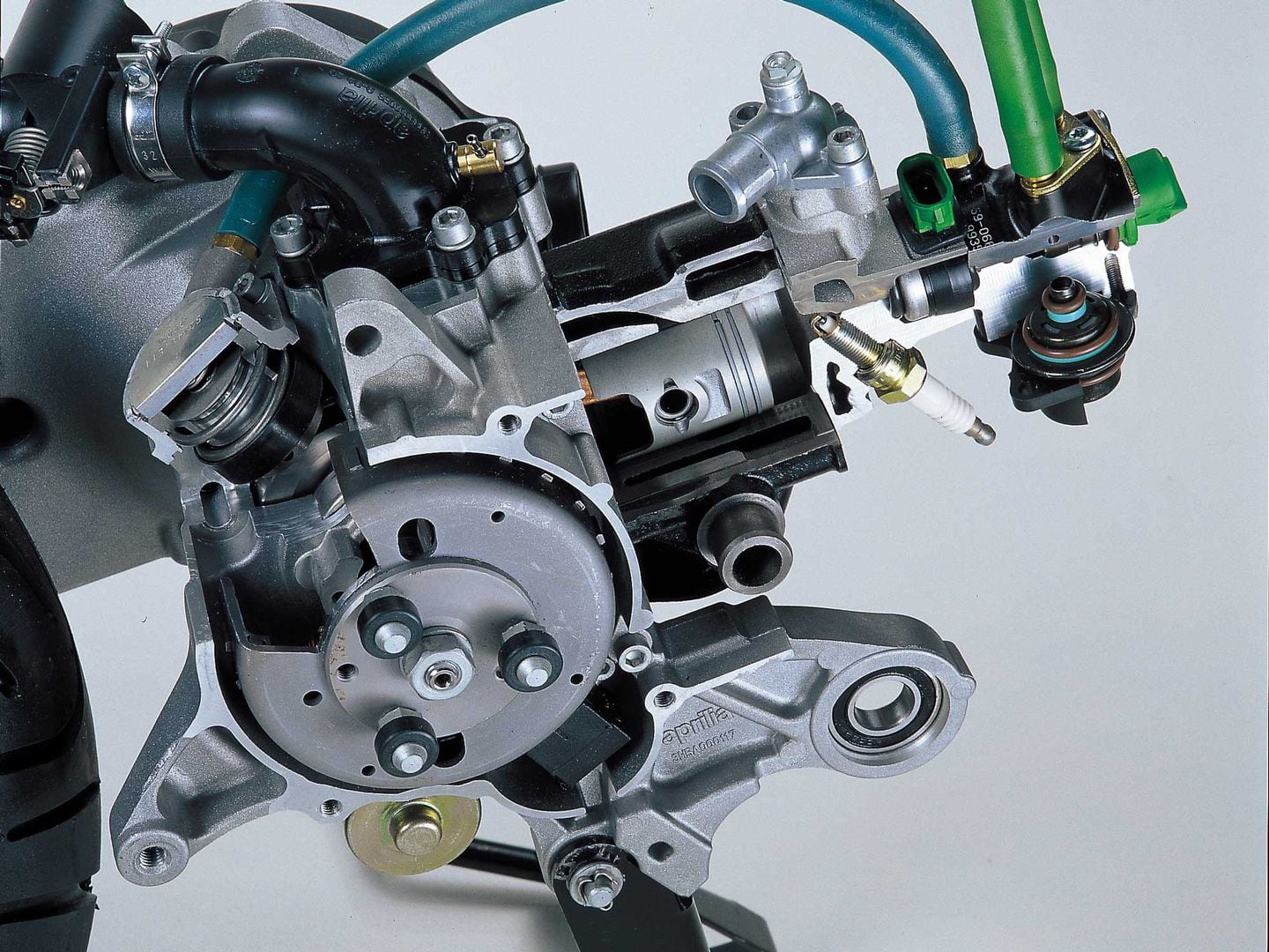

Clean at any rpm by injecting fuel directly into the cylinder AFTER the exhaust port is closed:
Aprilia's direct injection two-stroke engine concept
There a shaft driven air compressor involved and a lot of complexity.
Compare that to the simplicity and cost of Constant rpm 2-stroke.

That TPI system used by KTM and Husqvarna is not the same as direct injection, as the fuel is injected through the transfer ports instead of through the cylinder head. AFAIK the TPI doesn't rely on the compressor to provide a spray-guided injection similar to what Orbital Engines developed (and which seems to be what Aprilia was trying).
