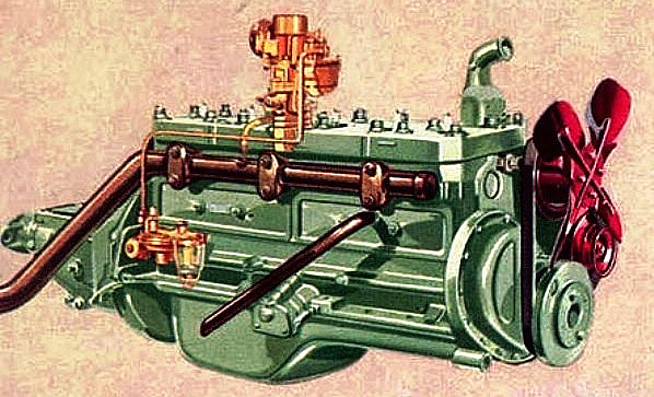

From the motor.com article:
www.greencarcongress.com: GM develops integrated exhaust manifold cylinder head for 3.6L V6 direct injection engine; improvement in performance, fuel economy, emissions and noise
The reduced complexity of the design of the new integrated exhaust manifold cylinder head (bottom) compared to the old (top)
My 1959 Nash Rambler had the exhaust pipe strapped to the side of the block and the carburetor was boxed onto the flat head.
https://www.macsmotorcitygarage.com/...9-Nash-600.jpg
I searched:
Intake (Air) volume is around 1/4 of exhaust gas volume IIRC and that's all due to the much higher temperature of the exhaust gas.
IMHO, if you do NOT have a Tuned Length 'Banana Branch' Exhaust; cooling the exhaust gasses means way less gas volume 'trying to escape' and THAT means less energy wasted by the engine having to 'push' it out.
ie: Heads (with built in manifolds) that cool the exhaust to the cooling system see this benefit.
I recall reading about some race class where you had to use the stock engine manifold and exhaust.
Someone enclosed the stock manifold in a water jacket, cooled by the stock (upgraded?) cooling system and saw something like 10 to 15 extra kw from doing so!
There is said to be a noticeable decrease in exhaust noise too, all else being equal.
ie: I don't think integrating un-optimized manifold systems into the head is worth the weight savings..?
But they do benefit from the extra cooling vs a std, un-cooled, un-tuned-lenghth manifold.
