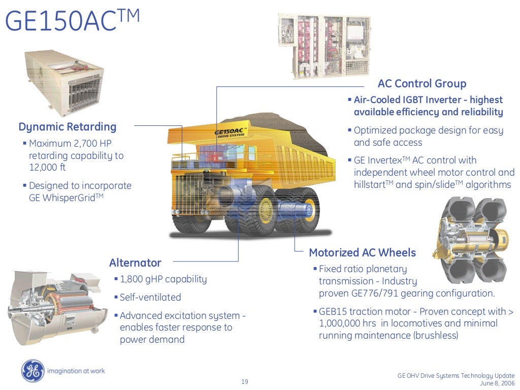

Even though I don't really hold my breath for hub-motors, I still believe they might have some utility once their design gets some improvements to make them more reliable under harsh environmental conditions.
GE has been using electric wheel motors in their series electric mining trucks for decades. In the right application they work well. The problem for on-highway vehicles seems to be the high bearing speeds required to go 80-100 mph
Full Slide Deck: https://www.slideshare.net/borisramo...-06082006-wmea
