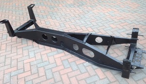

You'll need a chassis. I remembered that Lotus uses that all-Xmember chassis. It turns out you can get those too, reconditioned and power coated.
Lotus Chassis | PNM Engineering
The Elite is a monocoque. That's an Elan frame. The Elite was a real pioneer, and could be detailed better at the load take-off points. The most serious trouble was with the heat from the inboard rear brakes softening the resin.
