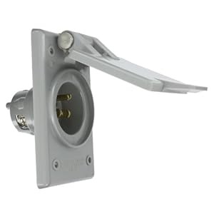

In my electric car I've taken to running heavy gauge extension cord from the charging plug to locations where I want stuff like heaters to plug in and I bought a Woods programmable timer with battery back up to turn my heater on and off.
My electric car is old enough that it just has a standard cord end inlet:
And it works really well! for a while for the heater I just had the heater cord dangling out the passenger door and plugging an extension cord in to a cord that is dangling gets old after a while, a ridged mounted inlet is much easier to deal with and the weather tight cover keeps the contacts clean!

Hey Ryland where did you get that plug?
The Inlet I bought at the local home improvement store, they are commonly used on the outside of smaller RV's and boats. Leviton 4937 Weatherproof Inlet on Flush Mount Wallplate with Aluminum Cover, Straight Blade Receptacle, Gray - Amazon.com is the one that I bought when I had to replace the one in my car after I used to light weight of a cord (16 gauge) extension cord and had the cord end melt, fusing it in to the receptical.
You can also get some really nice, heavy duty covers like this:
For about $40, or you can get light duty recepticals that have a plastic cover that is not spring loaded... personally I like the spring loaded cover, it always snaps closed and stays sealed!
You can also get inlets that are used on fire trucks, they kick the cord out when you start the vehicle and tend to cost $200 or more, personally I'd opt for a bright red LED that lights up on the dash when the car is plugged in to remind you not to drive away with it plugged in, or my electric car cuts power to the key switch when it's plugged in so nothing happens.
