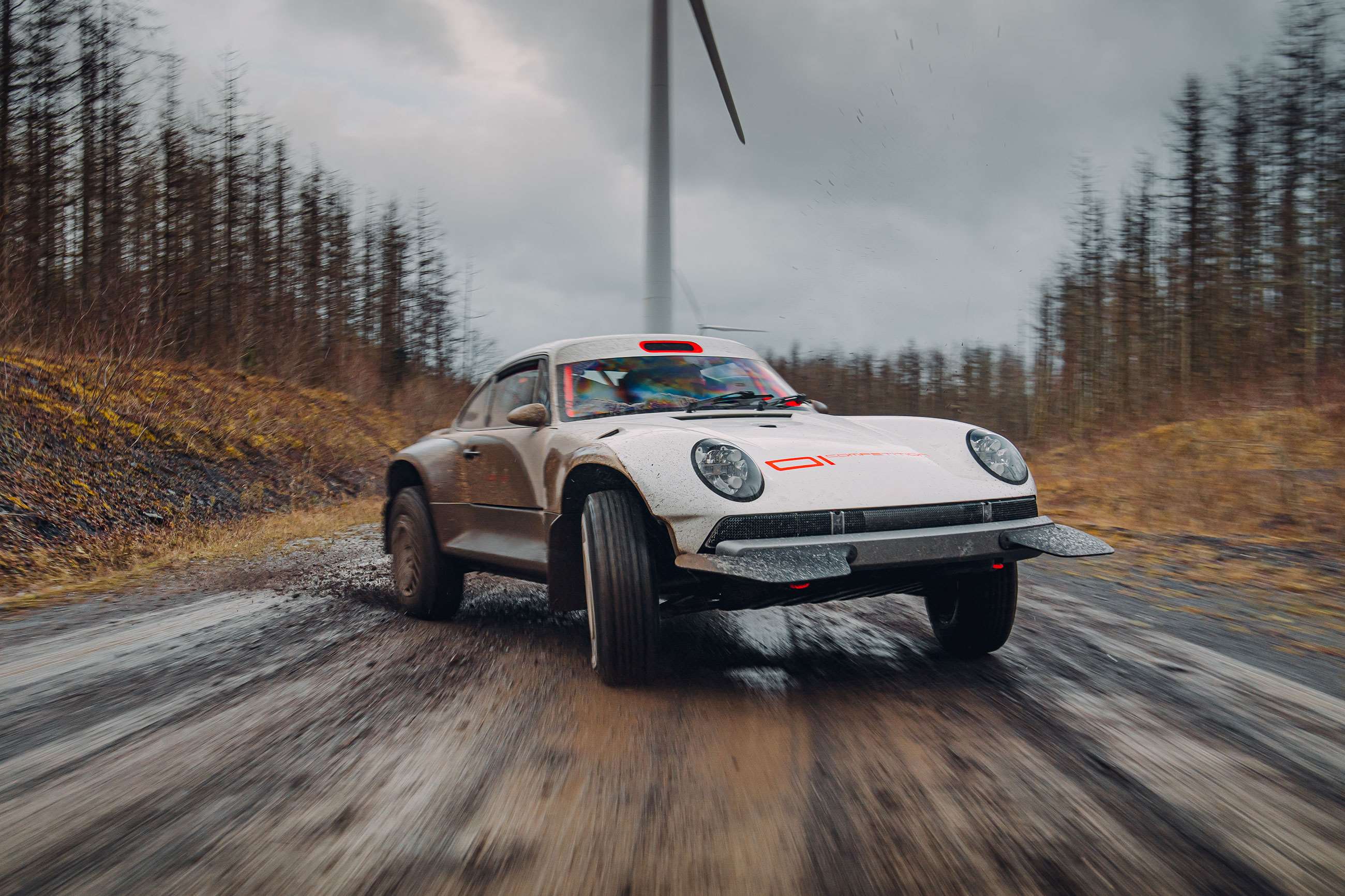

Another silly idea. Safari edition Civic?
The Singer/Tuthill 911:
Splitter for downforce plus crumple zone. (Just in case, you know?)

I love that car. I’m happy somebody else has seen it. She rips!! Porsche tried to sue them for it iirc. Bummer.
