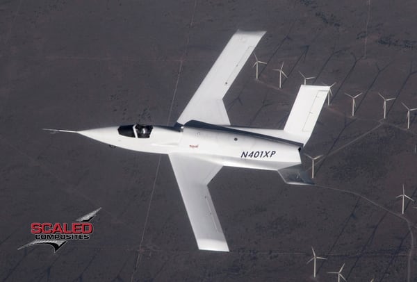

The Lear Jet had two turbojets on the fuselage and a T-tail. ....and a round fuselage. I'm more reminded of Scaled Composites.

LEAR FAN. Two intakes on fuselage, I believe a pair PT-6 turbo shaft inside, "Y" tail. The black engineering prototype was across the street from my old job.
Maybe your right, does have that scaled composites look.

SC definitely does the non-tubular fuselage thing a lot though... nothing like this either, really.

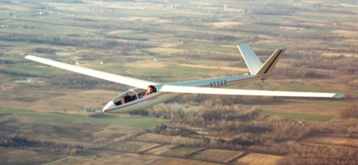

A V tail has less drag than a conventional tail, because there are fewer intersecting surfaces. A T tail is slightly lower drag, I think, because the intersections are farther apart? But the structural simplicity of the V tail gives it a bit of a weight advantage, maybe?
I am surprised a bit by the slim wings, and slender wing section.
The wing tip motor pods would seem to alleviate the vortex drag, I think?
I wouldn't be. If you're looking for maximum efficiency but not necessarily maximum speed.
Or high altitude and maximizing dwell time on not much fuel.
