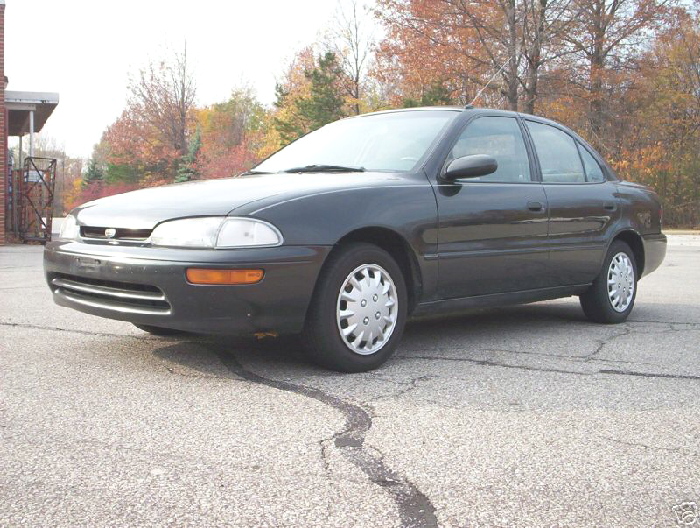

Want to put in a grill block. The car heats up really fast and engine temp gets really close to the middle line even in the bitter cold, so I don't know how much I can block and have it safe for summer. My grill looks like this
Would you recommend blocking the top, bottom or both? Which would make the most difference?

well... since it stays so warm... is your fan fuse working?

when i bought my old used car, i checked all the fuses, and investigated any empty fuse slots.
one fuse i found missing was the fan fuse. it was under the hood with a bunch of other fuses.
i saw a fan relay too, but once i replaced the fuse all seems fine.
you'll hear a fan kick on when your temp gauge reads about 2/3rds

Well there might be some miscommunication. My temp gauge is only hitting 49% right now.
I spose I should dig around just for kicks anyway though.

I'd block the top grille

I agree with Domman56. You can block the top grille, and maybe even the top half of the lower grille. If you use carboard for testing, you can just rip it out if it gets too hot.
I may be wrong, but form the pictures, it *looks* like you can stuff pipe-insulation tubing into the front of the lower grill. Some people do that because :
- It's cheap
- It's dark, so at a glance you don't "see" the mod in slots that are supposed to be dark
- It's easy to yank out if you are running hot
You may have vertical slats in the lower grille, so it may not be as straight-forward as I am describing. I am thinking you can cut a length of tube and stuff it in horizontally ... googling ... Ok, you do have vertical slats that are pretty close to the opening of the grille, so tubing may not work as well as I thought :

ive also seen people stuff those long pool floaters in there as well
but yeah, block the top, watch the temp, then repeat with the bottom
