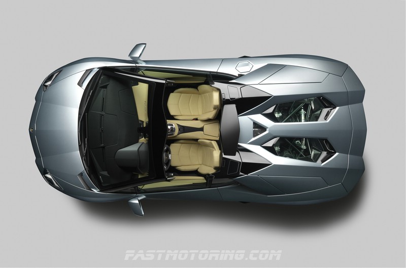

As close as some of these cars appear to be to the template, it should be mentioned that nearly all of them have an open notchback design that results in high drag.
Not to mention wide rear tracks and almost no plan taper.
That's an Aventador convertible, the standard coupe has a louvered rear hatch which is aerodynamically pretty good.
I wouldn't call the scoops on the Countach "almost no plan taper", I'd call them "anti-plan-taper" lol. They jut out right where you'd expect the pillars to taper inward.
It is a convertible, but the coupe has the same rear track, wider than the front. There's no narrowing of the footprint as you go back like you find with low-drag cars. Same with the Countach.
