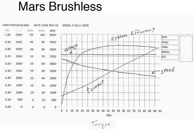

A couple things to consider on EV efficiency
electric motors don't like low load
batteries don't like high load
batteries do not necessarily charge efficiently "The coulometric charging efficiency of nickel metal hydride batteries is typically 66%, " How to charge Nickel Metal Hydride Batteries.
