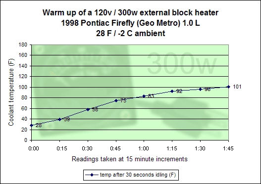

Talking with Darin, we think that a remote block heater might be semi-possible to do. With 4 hrs @ 36W I'd have 144Wh to play with. That would run a 300W block heater for a half hour. Not sure how much that would raise coolant temps, but its a start.
Edit, I forgot Darin actually did block heater testing. What a swell guy!
So, it looks like 30 minutes on the block heater would get me 10°F. Not really a huge savings, but if I did run the additional battery, I could drain it further without worrying about range. As the car sat during the week it could recharge this aux battery fully. Then, I could probably run it for 1 - 1.5 hrs. THAT would be significant!
edit: I see Darin corrected his images. It is a 30F raise. Not bad.

Since the graph starts at 0:15, the way I read it, half an hour will give you +30°F. Not huge, but it's something.
