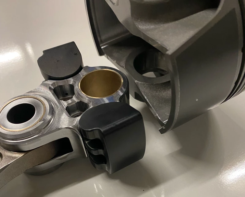

Two-piece con rods claimed to boost low-end engine torque by 30%
https://newatlas.com/automotive/two-piece-con-rod-thunder/
eliminate detonation, nox eliminate, quiet engine, reduce fuel consumption
