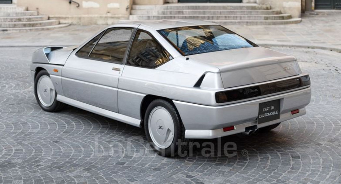

Are those slotted vents?
I use my brakes. Single lane roads here, and dangerous drivers. I’ve tried many times to hypermile in traffic, but people get violent if you don’t drive 20km/h over the speed limit and brake within 30 metres of every stop. Add to that the commonly carefree pedestrian that walks out in front of me. I try not to use them, but I end up having to. Overall, as little as I can.
I could just get better and try harder, but I’d like to have some cooling to be safe, doesn’t have to be more than a steel wheel offers.

What it is is a Photochop. It's ambiguous whether the louvers are innies or outies.
I suspect the design is compromised because the louvers will face forward half the time and backward the other half. But it is the smoothest. Drill the backing plates. Drill the rotors.
Have you analyzed the panic stops? A good balance between brakes and tires is necessary. My notchback Type III with 145-15s in front ran out of tires before it ran out of brakes, downhill in the Coast Range.

I’ve analyzed them, just after typing that post. They’re not that bad. I’ve never actually had a brake fade situation before, so I’m probably fine. Just like to consider the “what-ifs”.
I like that design. I wonder if adding a NACA duct, sort of like the covers on that concept car posted earlier in this thread, would be better? I want to see how they suck air in whilst spinning so fast. On that note, maybe you’re onto something, as your design would undoubtedly be good at scooping air in while rotating. I’d be surprised if half your driving is in reverse.
Has anybody messed around with Turbofans? I’ve seen them mentioned a few times on this forum but without much real insight. I figured they’d be bad for aero as they work like an air pump, but they covers on the VW XL1 are similar in design.

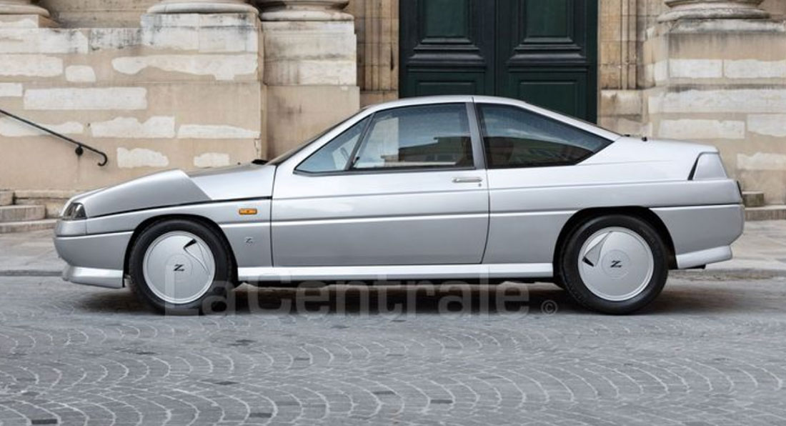

Those NACA ducts are continually in a cross wind (or turning a corner, I'm not sure).
www.roadandtrack.com/car-culture/a29760903/the-autech-zagato-stelvio-az1-is-an-italian-japanese-mashup-that-channels-an-era/
Sorry for the massive jpg There is a second oversized jpg of the headlight. It appears to have a hood over the light that feeds the vents above and below the mirror. Apparently an attempt to smother the wake from the mirrors. An 'air curtain' if you will.
