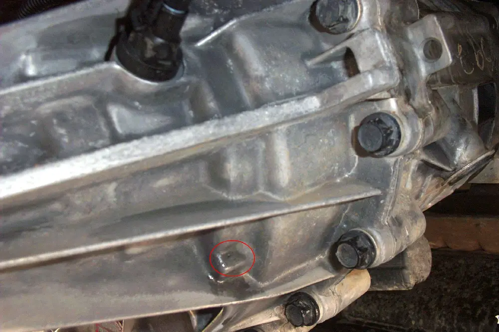

I had a 1999 7.4 gas 2500 Suburban. One problem we had that apparently was a design problem with the transfer case this year Suburban and even Duramax Diesel trucks of the next few years after, was a little clip inside would vibrate and rub the inside of the transfer case until it made a BB sized hole in it. Then all the fluid would leak out and ultimately cause the expensive transfer case to fail. When mine happened luckily I noticed the leak and fixed the hole with some JB weld which held up fine.

here is a picture of where the hole will develop on the outside of the transfer case
until it happens it's not worth worrying about. Like I said I fixed mine with $5 worth of JB weld but they do make a kit that can go inside and permanently fix it but it has to come out and apart for that.
