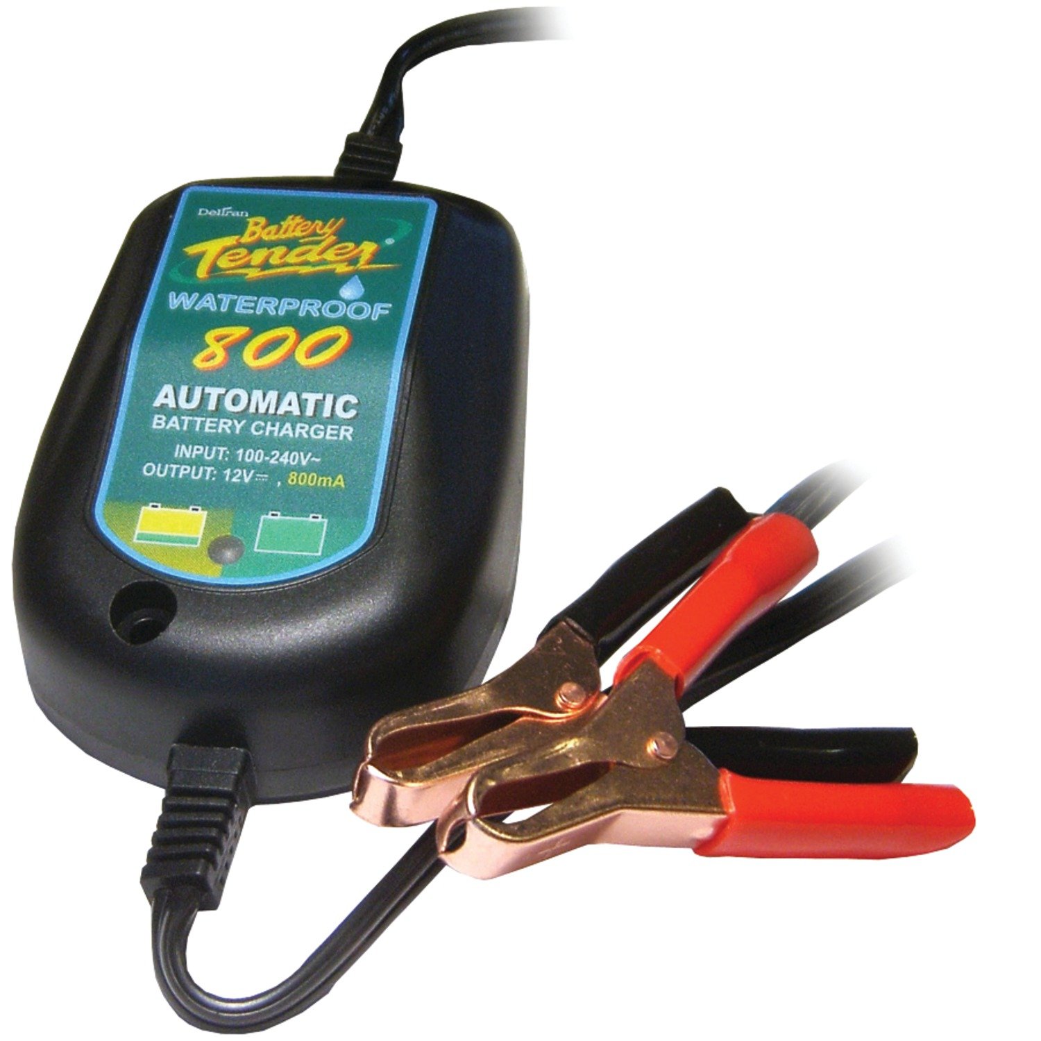

Nice! That grid charger looks pretty clean. Remember 24hr max is all that's needed. Also if you have an OBD2c&c you can charge your car daily without abusing it, I stated how in another thread, and the guys on IC think it's a good idea.

Only thing is, what's recommended as the best way to determine when to pull the battery off charge? Overcharging every day can't be good for it, and Honda limited the range of charge of the battery to prolong its life.

Well, I figure right about 166-169v is 80% SoC for me, so that's when I stop it. Once I get a OBD2C&C I can manually charge it via 3krpm rev and see what % the car considers "full" then plug in my grid charger and see exactly what voltage it's at, then use simple math everyday to figure out how long it needs to be on the charger.
Also no, it's not good for the car to charge it to 100% everyday. But charging to right around what the car considers full is actually better for the battery, as your trickle charging it at 350mA instead of the 15A or whatever it gets when you regen brake.

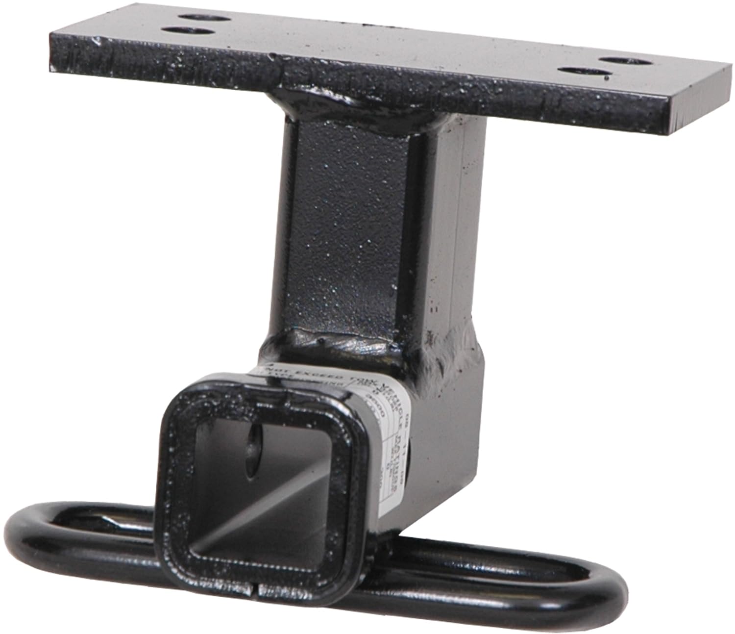

Just ordered a Reese receiver for $18:
http://www.amazon.com/Reese-Towpower...ds=reese+06625
My jaw near fell out of my head when I saw that price.
I'm planning to weld a bar to the back of the receiver and run it back under the cargo box for extra support. Expect a working hitch within the next month.

Friday night it was around freezing, so I plugged in the block heater and battery tender. In the morning, before starting the car, I checked the coolant temperature with my bluetooth OBD scanner, - 58c! I was barely out of the parking lot before the heat came on.
I drove my wife to work Saturday morning, and often when it's this cold we'll average as low as 35mpg getting to the top of the first few hills (~3miles perhaps). I was around 50 at that point, so I know the block heater will help with short trips and the first few miles of her work commute. Unfortunately, it isn't economical to leave the heater on all the time, short trips are often not predictable, and she is generally only awake maybe 45 minutes before getting in the car before going to work. I'm undecided yet if I want to run it overnight on weekends (she's a weekend receptionist right now) or leave a note reminding her to flip the light switch it's on in the mornings right when she wakes up.
