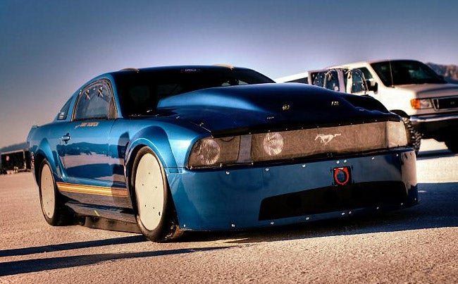

Agreed. And as you see here, it can even look nearly stock :
( Note the wheel well gap is very small and the tires are nearly flush with the fenders .)

This Stang looks real clean.
Danny Thompson Building 300 MPH Capable Mustang | StangTV
http://www.yellowbullet.com/forum/sh...hompson&page=4
.........................the blue one again.
