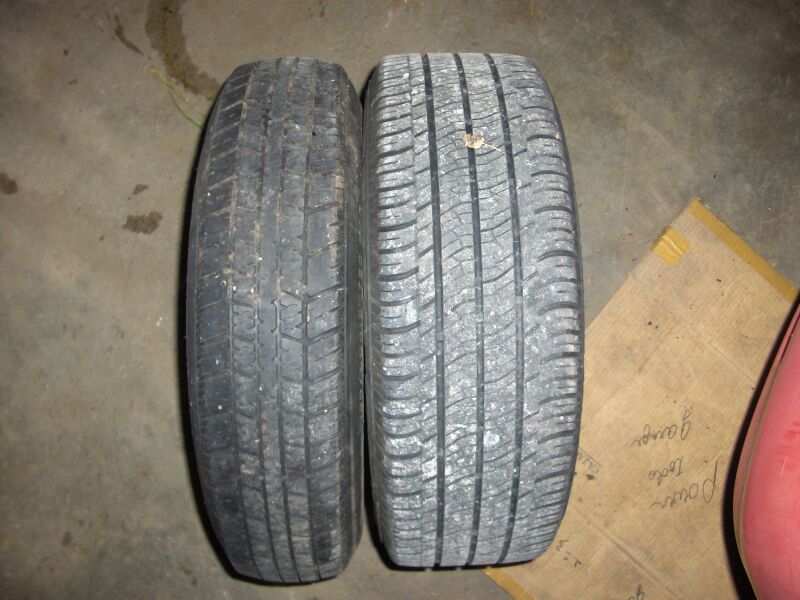

After some talking with Darin, he convinced me that going to a thinner tire had some very good benefits. So, I removed the 155 tires off my Tercel, and put them onto my Paseo which previously had 185 tires on it.
Here is a top shot of the Paseo and Tercel tire next to each other. They are the same diameter.

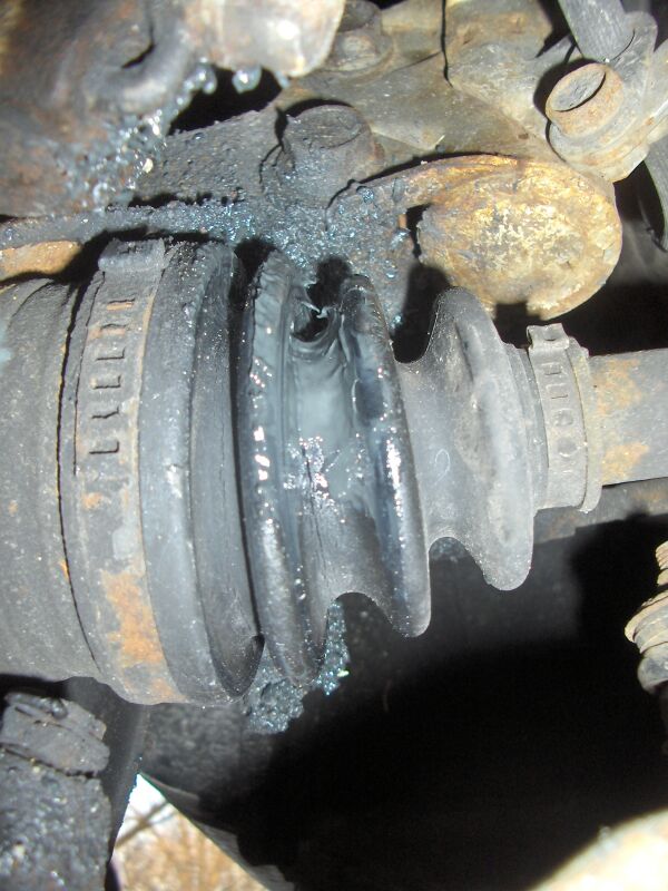

Fortunately (and unfortunately), while removing the tire I also found this mess. Chalk up another thing to fix on the Paseo.
