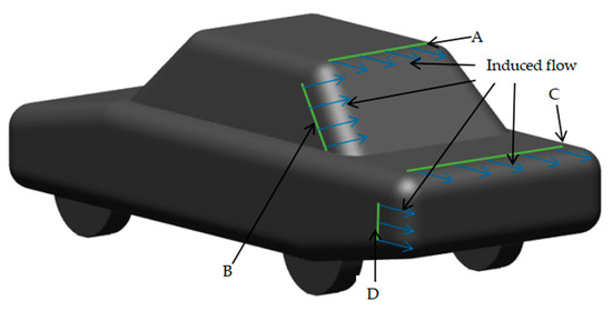

DBD for attached flow on a car's rear:
See an orange line: that is a plasma actuator one would place at the beginning of a shallow boat tail.
One too shallow or short to keep flow attached under normal circumstances.
NB the power required for this stuff from the previous post.

Aerodynamic Drag Reduction and Optimization of MIRA Model Based on Plasma Actuator
"...Specifically, drag reduction is better when the actuation is applied at four positions simultaneously. The maximum drag reduction coefficient of the car is reduced by 13.17%..."
... This suggests that the plasma jet can obviously inhibit the flow separation in the tail of the vehicle and strengthen the aerodynamic characteristics of the vehicle
https://www.mdpi.com/2076-0825/9/3/64

The obtuse corners at the roof and rear fender are most likely to generate a vortex (mismatched airspeeds on the top and sides). That's where the help is needed most.
