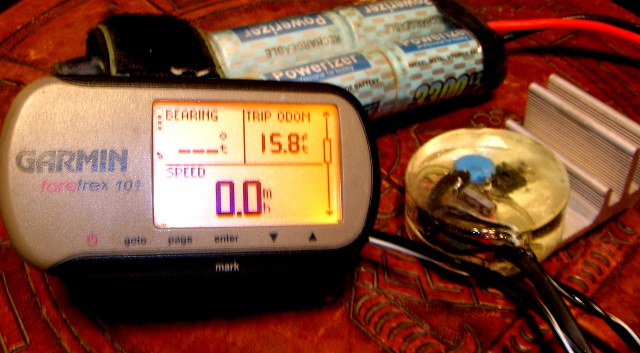

I appreciate everyones thoughts. I had a bike speedometer that lasted about 7000 miles before the reed switch disintegrated.
I have a plan now. I got a Garmin foretrex. It is powered by two AAA batteries. I am going to build a powersupply so that I can power it from my car.

I got my KA317, the solid state voltage regulator in the mail today, bought 10 of them on fleabay for 3 dollars including shipping. I built up and tested my circuit. Success, a solid 2.7 volts from car voltage (12-14 volts). Here is the circuit.
I used some resistors I had laying around r1=150 ohm and r2 a fixed 180 ohm. I am going to pot it in a small plastic box. I have a wooden dowel that I am going to use to make spacers for the battery simulator. Will get a picture of it.

Here is my voltage regulator hooked up to my Garmin. I used a couple of dowel rods to replace the AAA cells. I have tested it with 7 to 14 volts and the Garmin shows 3 bars.
I ran it for 15 minutes with the light on and noticed that that chip got hot so I added a rather large heat sink before I potted it. I need to connect it a switched circuit of the electrical system. Also mount the GPS to the dashboard.
