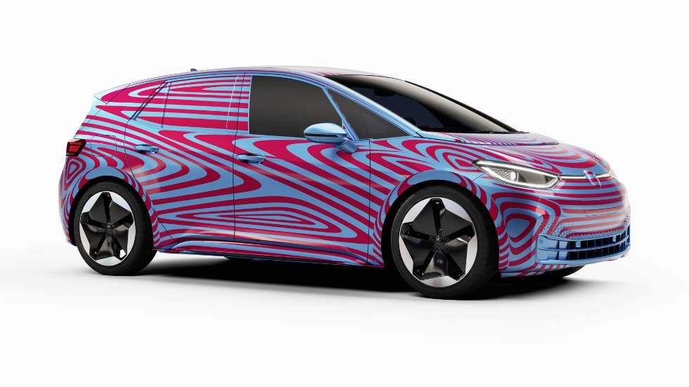

ID.3 Has 0.26 Cd!
The VW ID.3 has a Cd of 0.26! Very impressive for a hatchback.
VW ID.3:

Old 07-09-2019, 03:09 PM   #3127 (permalink)
Posts: 29,904
Thanks: 8,538
Three minutes earlier it was 0.23??
I think that was just a typo (or confusion with the Model 3 mentioned just before); the guy in the video said 0.26, but it isn't official.
ETA: If it is 0.26, that's very good, especially compared to something like the Bolt which is a similar shape but 0.32. Goes to show how much details matter.

Old 07-10-2019, 11:48 AM   #3130 (permalink)
I corrected my mistake.
