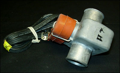

2. I bought an inline "circulating" type and found out I don't have room to fit it in the engine compartment.
BTW, it doesn't really have a circulating pump in it. It works only by convection.

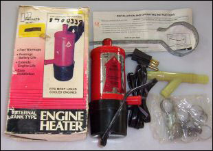

3. At one time, there was an OEM BMW part that bolted directly to the side of the block, but I think it was made out of unobtanium. I'd buy one if I could find it.
Click to see article.
The part# Googles up with 2 hits (well 3 but one is a dupe). In both cases, it seems the part is discontinued or no longer available. It was made and sold in Canada but apparently not in the U.S.
Maybe some of the ecomodders from Canada might be able to assist me here. If you know of a BMW dealer up north that deals in this kind of thing (I've read maybe Saskatoon), let me know.
4. The pad-type that attaches to the bottom or side of the oil pan might work. The magnetic type is out because the pan is, of course, aluminum. There is an adhesive type that might have promise (similar to this one)
...if I could find a flat spot on the pan:
5. Lastly, I may try a "non-circulating" inline type that connects to the lower (not upper) radiator hose.
I'm not sure it will help if the thermostat is closed: won't it only heat the fluid in the hose and leave the long straight-6 block in the cold? I'm willing to try it if nothing else pans out (no pun intended).

I would start calling dealers. Locals first then I would move north. You'd be surprised what odd parts some dealers have in stock.
You may also call salvage yards to see if they have any engines. You may find on an engine that someone is willing to let you take off. The one you show that is appears to be OE looks like it bolts to the side of the motor.

I'll bet that little jewel was one expensive piece... Based on a few of the specialty parts I've bought for my BMW..
BTW the hose mounted heaters I've put in called for going in the lower hose.
I read $140 and $88 from dealers in Canada (probably CAD $ as well).
