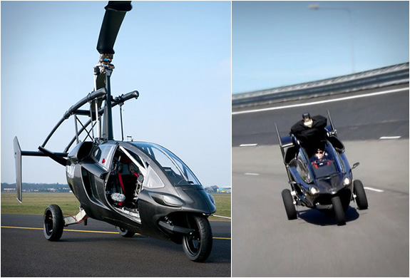

I wasn't going to post these so the idea wouldn't distract the technical discussion. Looks like that's been fairly well covered, so now some fun:
http://http://pal-v.com/
Super Sky Cycle, The Flying Motorcycle | motorcycle News @ Top Speed
Meet Dezsö Molnár and His Flying GyroCycle - Tested
But I want to do it under 103. The prop idea was to reduce weigt to allow a 4 stroke.

Now that's an even bigger why. I can, barely, see the point of a fixed-wing roadable ultralight - you might not have room to take of/land close to your destination - but with a helicopter? And with an autogyro, you still have to have a takeoff run.
And if you want it under FAR 103, remember you'll have to add weight for things that make it road legal, like head & tail lights, turn signals, etc.
2 strokes are just temperamental and more prone to failure. They're also less efficient overall, but very light in hp/lb.
And having it roadable allows me to find a spot to use for takeoff and landing. At home its not a problem the driveway alone 800 feet. Destinations are a problem. A Pre-rotor would help, and may provide a method of propulsion tying into that system (if hydraulic).
No turn signals here. Will need a headlight, horn, tail/brake light, and one mirror. A gryo seems like the best option. A helicopter would be hard to make light enough, and a plane too bulky. If a 60 year old square tube Bensen can be under 254, an updated design with emergency gear allowances, some propulsion system and street gear should be doable.
Shooting for 600 miles of range at 65-70 mph out of a vx.
So how far are you looking to travel on road at your destination?
My solution (with a Piper Cherokee) was to just take out the rear seat so I had room for the mountain bike. And would land on dry lakes, or the occasional stretch of deserted highway.
I honestly wouldn't think that would be at all practical, with the large rotor hanging out there where it can bang into things, or be hit by people not seeing it. Even if you could secure it fore and aft, it'd still be like carrying long pieces of material sticking out the back of your pickup. You really have to give some thought to Murphy's Law, you know :-)
But I do understand about not wanting 2-stroke power.
