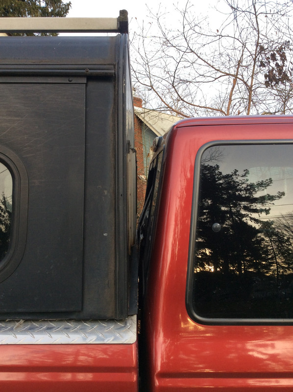

I did take a front pic, but can’t open the hosting site to retrieve it at the moment. I’ll add it when I can by editing this post or making a fresh one.
The cap is about 1” narrower than the cab at the leading edge of the bed. From there it tapers at a steeper angle than the cab, so it protrudes a couple of inches from the top of the cab. This cap was originally on a 2004 Tacoma, so some of the fitment anomalies could be due to that, though it didn’t match the Taco cab especially well, either. I suspect A.R.E. makes the roof panel the same size across the DCU line, so the sides get more vertical if a raised roof is spec’d.
My longer-term plans are to narrow and change the roof panel so that the sides lean in and the cap tucks in behind the cab proper. This will be a major de/reconstruction of the cap to optimize its work/play/travel roles. I’m accumulating parts and materials for now in hopes of diving deeper into the project this coming spring. I worked for over a decade making signs and awnings with 1”x1” square aluminum tubing, so I’m very familiar with the material and look forward to tweaking this cap to my liking.
Later in the week, I’ll post some sketches of what I’m thinking about.

Here is a front view of the steep angle of the cap. Long term plan is to nip and tuck the angle inward so that it matches that of the truck cab and no longer protrudes thusly.

The other goals at the front end are to remove the protruding lip at the bottom, replace the protruding window with a more flush-mounted one from another cap, and angle the front of the cap to better match the cab.
