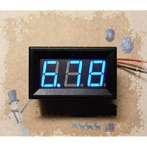

Having dual 12-volt deep cycle batteries begs for a nice dual voltage gauge display. So I finally built it. The real driving force behind that need was that my particular ScanGauge has a very jumpy voltage display; the apparent voltage goes up and down seemingly without rhyme or reason. So it's not a good tool for monitoring batteries, a critical task in my application. This gauge solved that issue. Readings respond instantly to known changes, such as lights being switched on or off. Otherwise the display stays perfectly stable.
I found this panel gauge available on Amazon for $10.98 plus shipping:
Here's the link to the item: Amazon.com: Mini Blue LED Digital Volt Meter 4.5~30v for 9v 12v 24v: Electronics (also available in red)

Low cost.
Easy to understand wiring: One red wire, one white on each gauge.
Relatively small: 48mm x 29mm x 21mm deep.
Very accurate: the two gauges read identically when connected to the same source and match my nearly new, ~$60 multitester.
The leads are detachable via a plastic connector.
Not quite so good:
No brightness control. They are the brightest thing on my dash, can be read in full sunlight.
I built two of these into one project box, which I then velcro'd to my dash. One hot lead goes to my lead acid battery, the other to the lithium. I joined the ground leads inside the case and ran that lead to a switch, and then to ground. I soldered the ends of the gauge leads to my 6' long, 22 gauge wire leads. The other connections at ends of those leads are crimp connectors. I folded over the 22 ga wire so the red crimp connectors would have a double thickness of wire to grab onto.
