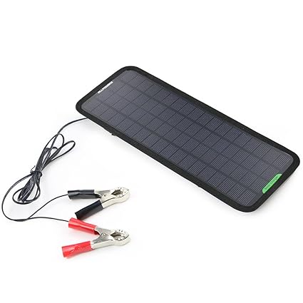

This is mine, an OEM VW part. I use it on the Dasher because it's battery is weak.
